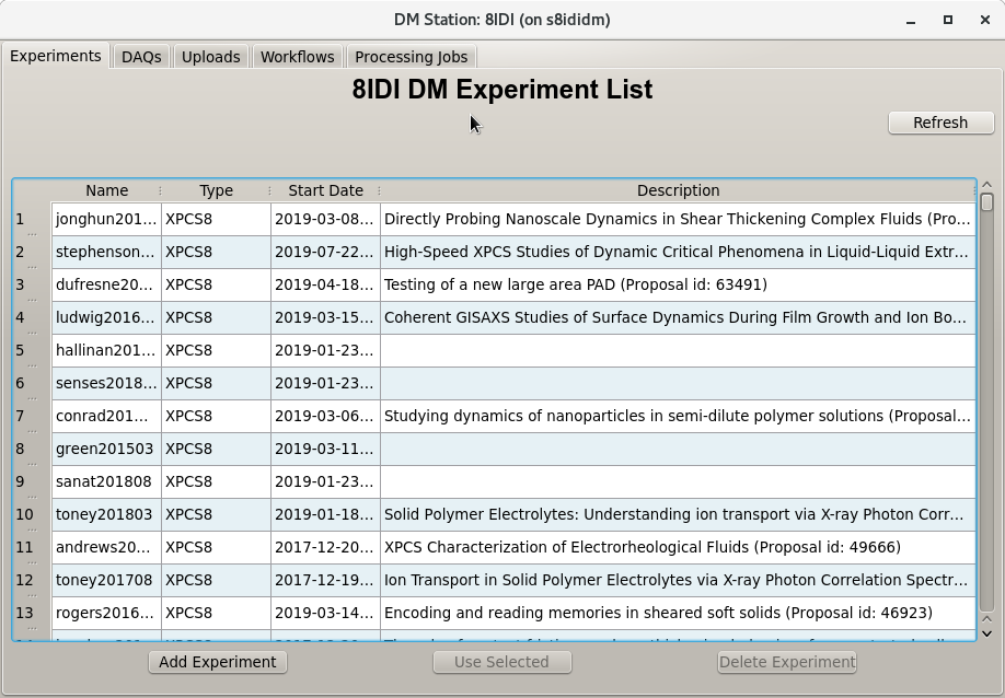

Experiments
dm-station-gui
opens showing a tab that lists experiments which have been added
to the DM System. At the beamline, these experiments generally will correspond
to an accepted proposal in the APS Proposal system. Experiments in the DM
System define an entity that ties sets of managed data together. When an
experiment is selected by double clicking or by clicking and then clicking the

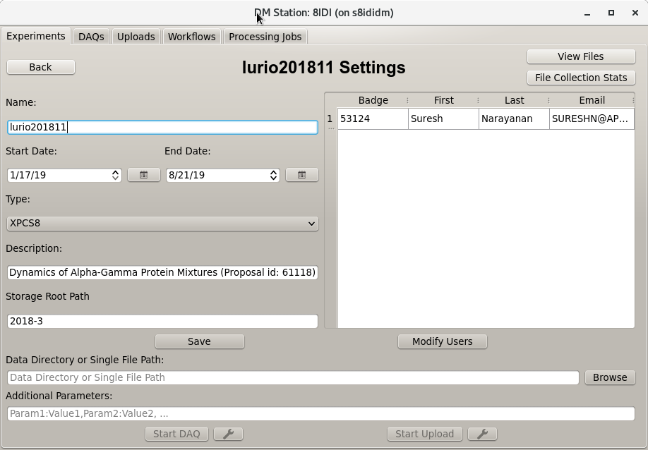

Use Selected button, the contents of the Experiment tab changes to give
details about that experiment. Much of this information is pulled from the
proposal/ESAF databases. This is shown in the image below.
This view of the data enable a couple of key features of the DM System. The ability to associate files with the Management system, and the ability to set which users have access to the system and therefore which data they can access. Selecting users that will have access to experiment data is done by clicking the Modify Users button below the user list and then selecting users in the right list & pressing the arrow button between the lists to add users or selecting users from the left list and clicking the arrow button to delete users from the list. Click the Save button at the bottom to accept the changes and go back to the Experiment detail or click Back button in the upper left to exit back to Experiment detail without saving. This view is shown below.
Getting Files into Data Management
The overall purpose of this system is to get data into the system and providing
access control to that data. This means linking the data files to the users in
an experiment. For each beam station there is storage location defined for that
station. On the Experiments
tab there are a couple of items relevant to
getting the data onto that storage location. These items are shown in the image
below. Files transferred onto the storage location will go into:
STORAGE_LOCATION/(storage_root_path)/(experiment_name). Files to go into this
directory are specified in the entry "Data Directory or Single File Path". Note
that if the data directory is specified, only the files will go into the
storage location, not a new sub-directory with the transferred files. Any
sub-directories will be copied as will the contents.
